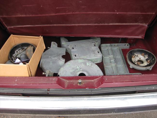

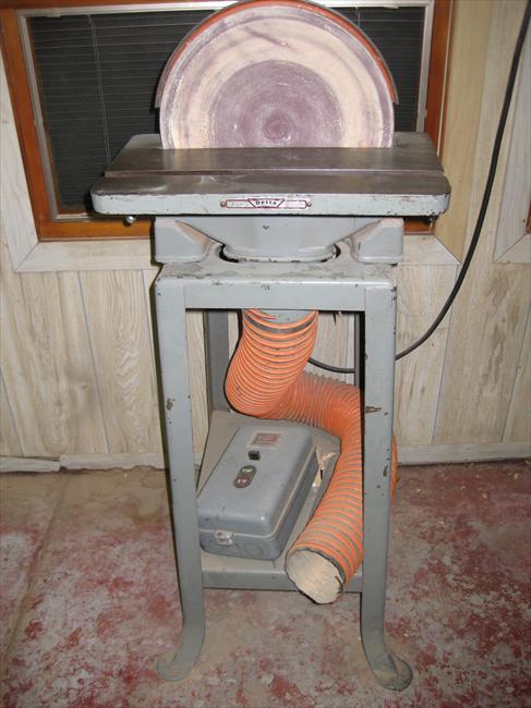

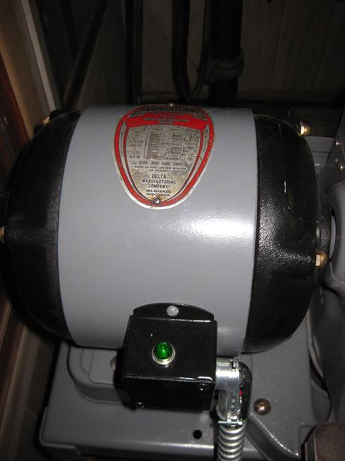

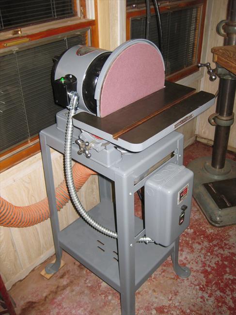

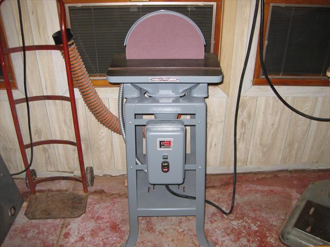

I purchased this from Sean, in Lancaster PA through the site here. I need to contact him to see if he knows some history on it. It had at least three coats of paint--Original Delta gray, machine green, and brushed on light gray. It has been restored. I stripped it down, sandblasted all the parts, and sprayed the parts with a gravity feed paint gun. I uncovered the original "Delta Quality Tools" decal, which I'm trying to reproduce. I have added an old Furnace mag starter, new bearings, and a green indicator light, to fill the hole where the toggle switch was added in at some point along the way. I also had Cattail foundry cast a dust port for me since mine was missing. This thing runs great, especially for a 70 year old machine.
Before disassembly. Mag starter to be installed.

Stripped parts in the back of my turbo caravan, waiting to be sandblasted
my camera

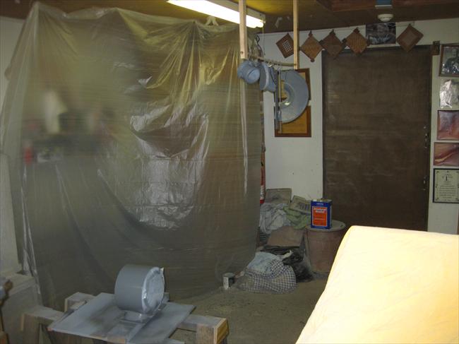

Parts in the shop with one coat of Delta Gray paint on them
my camera
