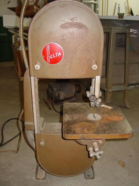

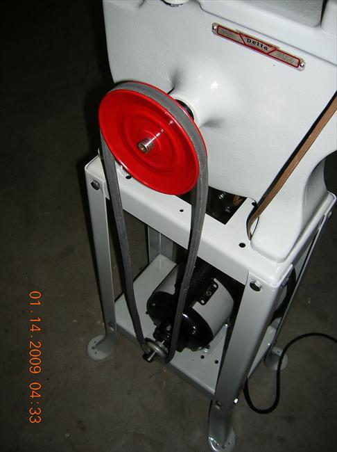

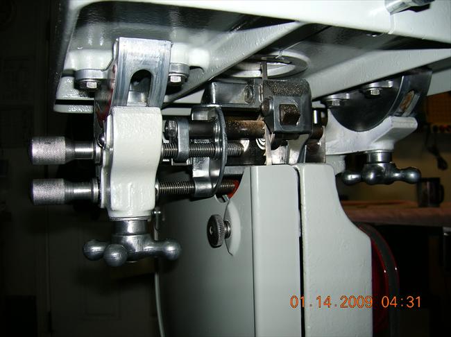

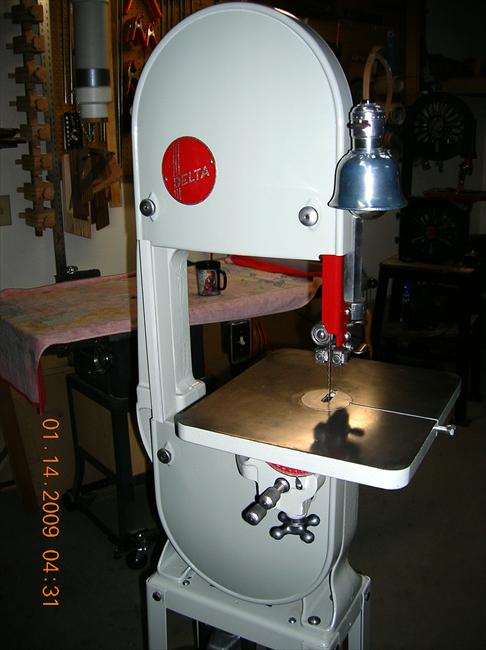

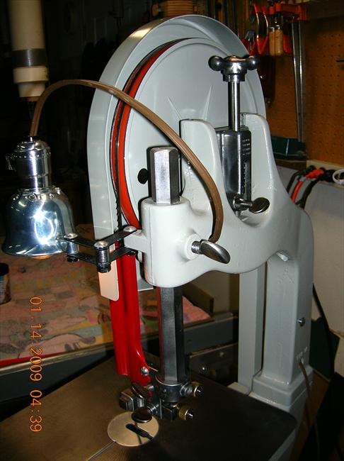

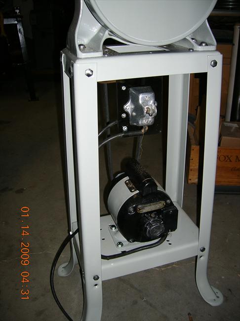

Purchased this machine from Michael Thompson in Portland in unrestored basket case condition. It was a c-list purchase and was remarkably complete needing only the table pin. I gave it a good cleaning and polishing along with a new paint job, new bearings, ureathane tires and a new throat plate. Used what I believe is a period correct GE 1/3 hp sleeved motor. I also added a ret. lamp after polishing it. I was able to save the patent decal on the rear of the frame although I do not show it here. The machine runs like a sewing machine and even with a std belt I can balance a new quarter on edge on the table while the machine is running...The red paint is the danger areas and is habit from days when I was a shop teacher. ( this may in fact be an earlier model 768 but there are no holes drilled in the al wheels)
After restoration

Condition when obtained

Underside of table

motor, belt, and badge

GE 1/3 hp motor and unique toggle switch holder

Ret lamp and cord routing through frame and new tires
