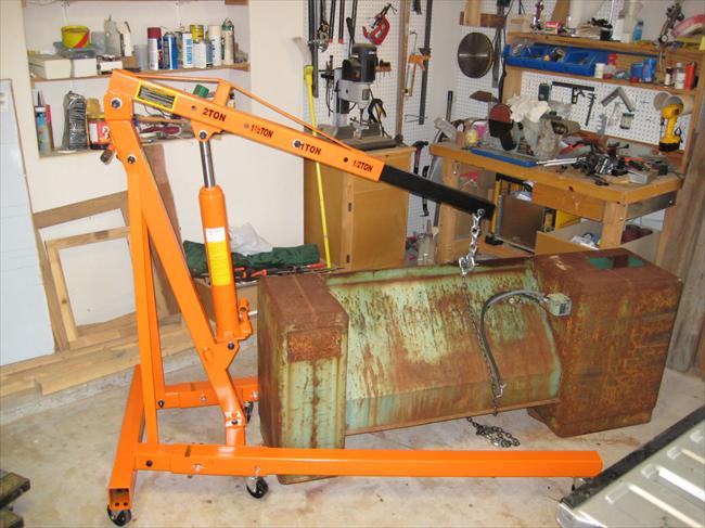

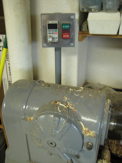

I bought this machine from a fellow OWWMer in Dallas who bought a bigger lathe. All bearings were replaced, motor rewired, and replacement accessories. Added a VFD and set up the remote controls.
The down side was it never had a factory base and he had it mounted to a workbench. By chance I found just a base from a Dallas machinery dealer, cleaned it up and gave it a new stand.
Update 5/5/09 - I bought a second PM 90 base and bed with the idea of putting two together for longer turnings. It wasn't very easy to make the two match up, but I finally found a workable solution with an adapter to join the two end-to-end.
Comments: fully restored
Comments: base before clean up
Comments: adapter, 5/8" plate for rails, 1/2" plate on other pieces, 1/2" bolt holes
Comments: adapter installed
Comments: provides 7' b/t centers, overall length 11'
Comments: close up of VFD controls
