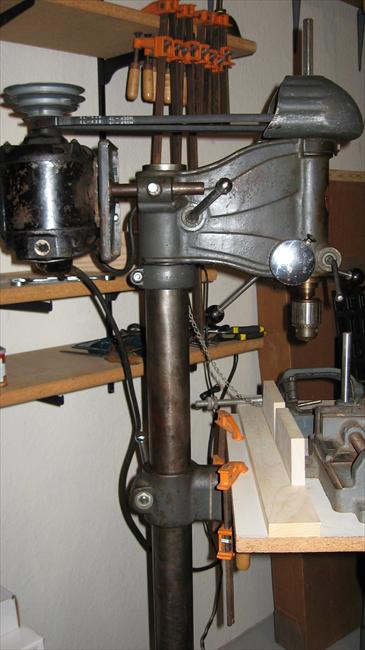

Comments: Atlas 74 with a Temporary Table used for woodworking
Source: Bob Harford

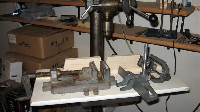

Comments: Columbian Vise & Atlas Mortising accessories
Source: Bob Harford

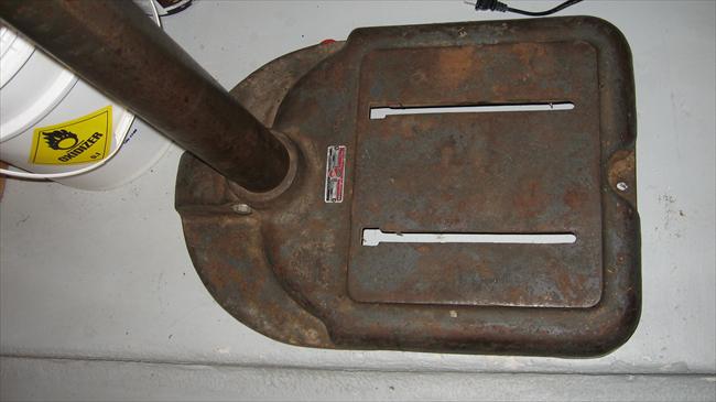

Comments: Base with ID plate
Source: Bob Harford

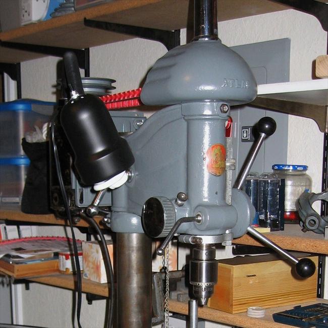

Comments: Refurbished #1 -- Model #74 w/ new Jacobs 633c chuck & replaced depthgage/quill stop and spindle cap -- added lamp
Source: Bob Harford

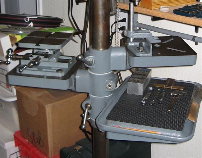

Comments: Refurbished #2 -- Turned the old #74 into a multi-table tool -- or, #74 on steroids -- used cut rings of UHMW poly as bearing surfaces on the press column.
Source: Bob Harford

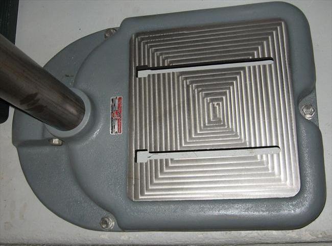

Comments: Refurbished #3 -- Had all tables and the base surface milled after cleaning/media blasting -- base now bolted to floor
Source: Bob Harford
