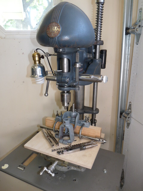

This is a basic DP220 that included the production table and foot feed when acquired. I cleaned it up (didn't paint the castings), degrimed the steel parts, fabbed a couple parts (including the switch rod), and tuned everything up. Then I added an X-Y table from an unrelated machine, acquired the various parts for a mortising kit, and made a table assembly that installs/removes using just two bolts through the drain holes in the production table moat.

mortising setup
mortising kit - 974 spindle not installed
mortising XY table
