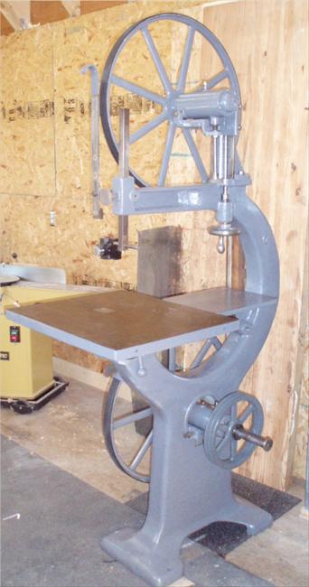

Comments: Machine from the front
Source: photo by owner

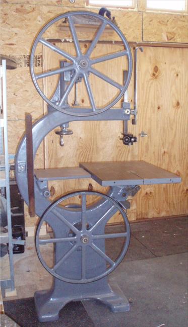

Comments: Machine from the back

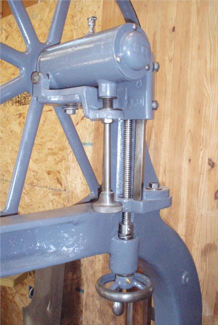

Comments: Detail of tensioner / upper wheel adjustment

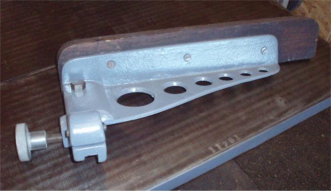

Comments: Original rip fence and serial number on table

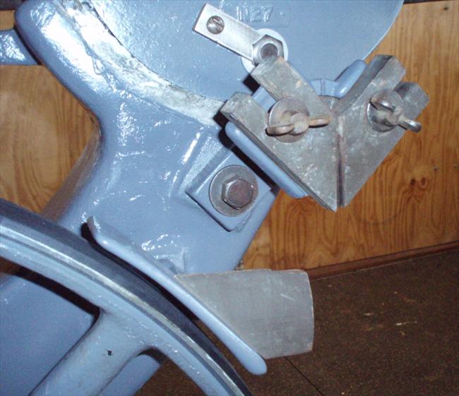

Comments: Detail of lower guide and sawdust deflector

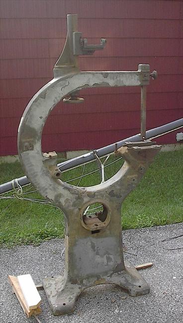

Comments: Main casting prior to restoration
