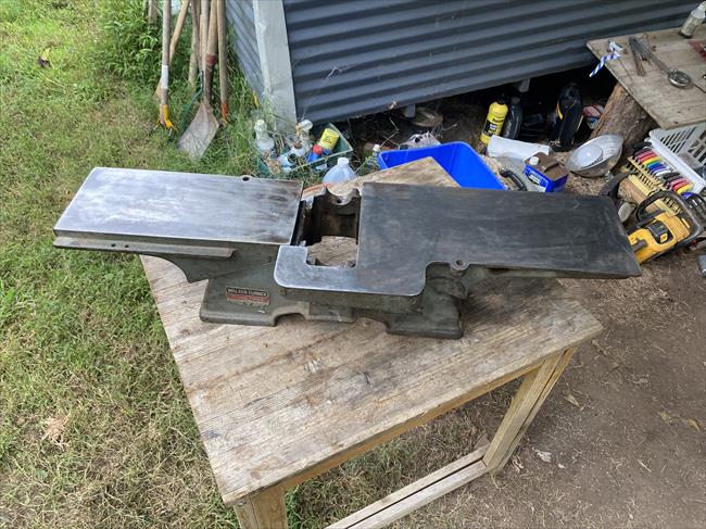

                                                    Source=Owner's submission. Owner's notes: $45 from Habitat for Humanity Restore in Brevard, NC. No motor, no stand.
Replacing bearings with Triton model 38454-2RS-PRX sealed ball bearings from Grainger.
Looking for crown nuts for table height adjustment knobs; hard to find, 1/2" diameter, 24 threads/inch.
Not badly rusted, but some dents were distorting the surface of the lower table. Nicely resolved with a belt sander with a 120 grit belt. |
