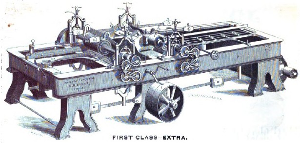

Beginning in 1840, John H. Lester of Brooklyn manufactured Woodworth planers for which buyers could get a license from the Woodworth patent cartel. He also made a variety of other products, including steam engines, boilers, and metalworking machinery. So far as we can tell, his business had slowed down or disappeared by 1857, the Woodworth patent having expired in 1856. It is known that the other makers of Woodworth planers, Schenck Machine Co. and John Gibson, were resented by their customers because of the behavior of the Woodworth planer syndicate, and saw their business virtually disappear as soon as the patent expired; it seems that Lester suffered the same fate.
Lester planing machine from the 1856 book, "The Historical Picture Gallery, Vol. V", by John R. Chapin
