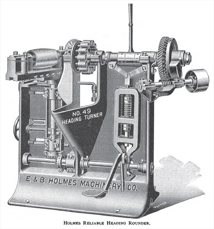

 We therefore invite your attention to the cut which represents a most perfect machine for turning or circling barrel heads for slack barrels, or any kind of heads where the heading material has been brought to an even thickness. Heads from seven to twenty inches in diameter can be turned on this machine by having the proper size clamps and saws. Machine is furnished complete for turning One Size heading. It is Automatic in its operation, discharging the head when turned. The action of the foot lever clamps the head and then swings the saw into operation. The upright lever is used simply to disengage the saw and head, if desired, before the head is fully circled. Machine is fitted with swinging mandrel and saw, which does the work much easier and smoother than a fixed mandrel. It is strong, durable and not likely to get out of order.
 So say the E. & B. Holmes Machinery Co., of Buffalo, who manufacture this and many other cooperage machines. They will gladly send information as to this machine or any machine shown in their great catalogue. We also call attention to their advertisement in each issue of the Journal as a new cut is shown every month.
