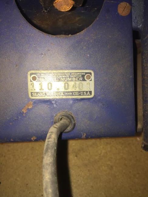

110.0401 Sears Dunlap Scroll Saw Magnetic

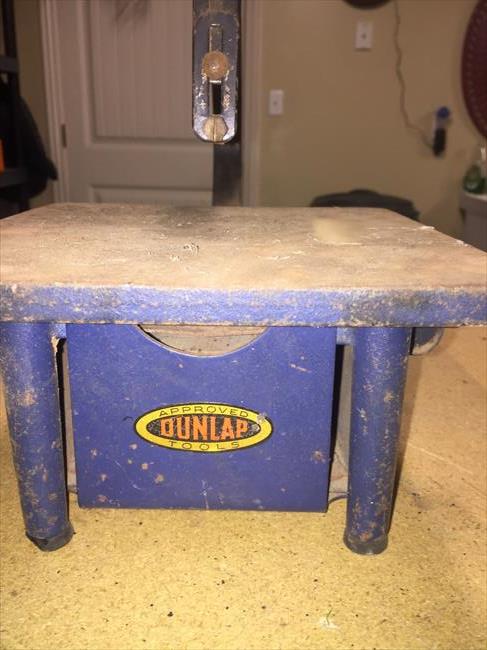

Found in father-in-law storage unit. Never had seen one before. Not sure what blade to use, tried a 5" but does not seem to want to cut. A 6.5" coping saw blade seemed to work better though not well. Any insight or information would be appreciated.
(Admin BAK, 11/5/2018: Revised specs. I had the same issue with a 1950's version of this saw. The magnetic field was not strong enough to move the compressed spring arm with a 5" blade. I found 6" pin end coping saw blades worked fine in my saw.)
